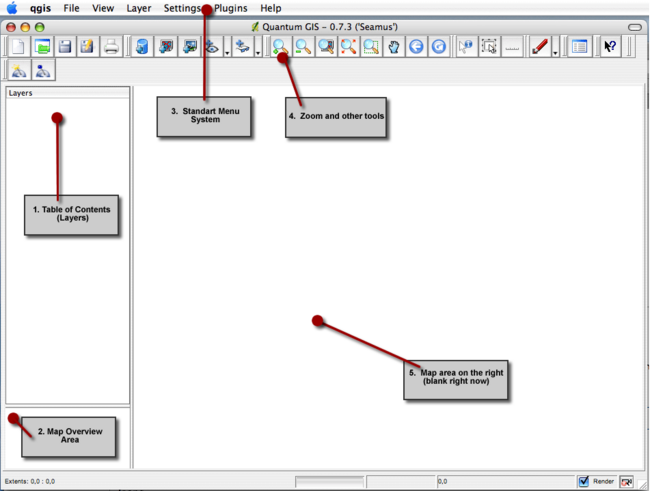

There are 5 major areas of QGIS main screen (Figure 1):
- Table of Contents (layers) on the left
- Map Overview Area
- Standard Menu System
- Zoom and other tools in the button row
- Map area at the center (blank right now)
- Status bar (area at the bottom of the application screen)

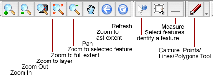

Icons
Look at the Icon Menus/Toolbars. The major toolbars buttons are described below (Figures N-N)

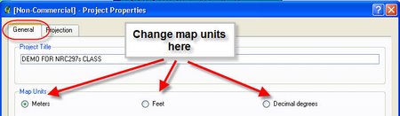

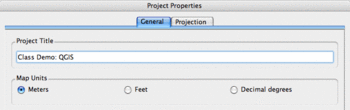

- To set project properties click "[Settings > Project Properties]" in the main menu. The "Project Properties" window will appear.
- Click on the "[General]" tab and set Project Title and Map Units. Call this project Class Demo:QGIS and set the Map Units to Meters.
- To set the projection of the project, click on the projection tab and find Projected Coordinate System, Lambert Conformal Conic, and NAD83 Massachusetts Mainland.
- Click "[Ok]" button to make changes. (Figure 6)

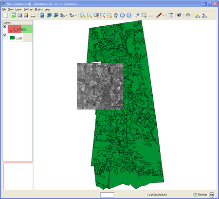

- You have two overlaying layers now in QGIS (Figure 8):
- If you don't have the raster image in your view, then select any layer in the Table of Contents (TOC) and click the "Zoom to layer" menu button. The view should refresh itself and you will be able to see two data layers (Figure 9).

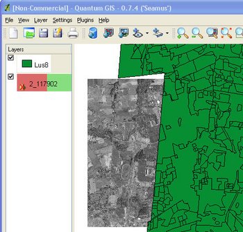

- Click on the raster file (2_117902.tif) and drag it down so that it is listed in the table of contents BELOW the land use vector layer. You should see the raster image covered with the land use layer (Figure 10).
- If the land use layer does not cover the raster image select "View > Refresh"

- To specify/change display units click Setting > Project Properties and click on [General] tab in the window (Figure 10). It's a good habit to specify these settings when you start working on the project.

- Whatever layer is at the top of the TOC will be displayed on top
- Move the raster image to the top of the table of contents
- Click and hold on the 2_117902.tif image
- Drag this up to the top of the TOC
- You should see that some line and polygon features disappear because the raster grid is overlaying on the vector layer
