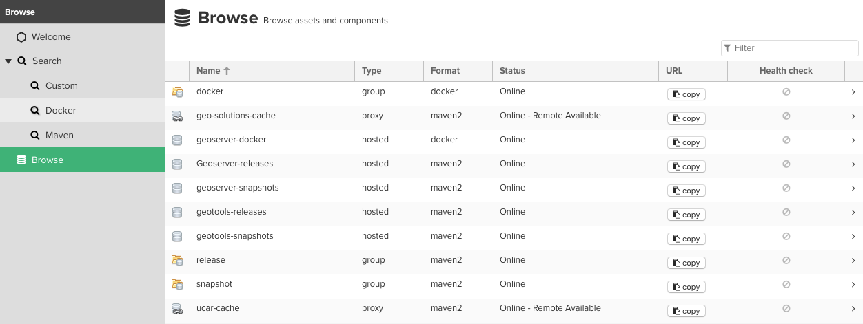

Nexus
The repo.osgeo.org is currently managed as an instance of Sonatype Nexus Repository Manager as shown below.
- This is a repository manager intended for use by build systems
- If you like you can use search to locate specific artifacts
- Nexus also offers a chance to browse contents with an html view
- Artifact URLs are stable and can be used as an alternative to downloads.osgeo.org and does provide download counts.
Repositories
Maven repository naming conventions:
- project-releases (hosted) - each project manages its releases in a distinct hosted repository. They may wish to upload third party dependencies here also.
- project-snapshots (hosted) - each project with build automation manages its snapshots in a distinct hosted repository, subject to a policy expiring artifacts after an appropriate time
- external-cache (proxy) - external repositories can be cached at repo.osgeo.org to improve build times. Each external repository subject to routing policies to limit contents stored.
- release (group) - Gathering all releases (from multiple project releases repositories, upstream cached repositories) providing a single repository for the community
- snapshot (group) - Gather all snapshots from osgeo projects into a single repository for the community
Docker repository naming conventions:
- project-docker (hosted) - each project manages images in a distinct hosted repository
- docker (group) - Gather all docker projects into a single repository for the community to pull from
Nexus stores artifacts in blob storage (presently on the file system). We are defining different blob stores for different kinds of content:
- releases - osgeo projects artifacts
- docker - policy will be defined in conjunction with initial projects making use of this service
- snapshots - publish transit artifacts produced from the active development branches (See automation below for cleanup policies and tasks)
- cache - isolated into separate storage so we have the option of avoid backups in the future
