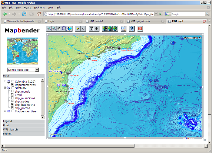

Screenshot of Bathimetric data off the Brazilian Coast
This screenshot shows several WMS services, one with bathymetric data off the Brazilian coast. Check Sudamerica for the corresponding WMS GetCapabilities URL.

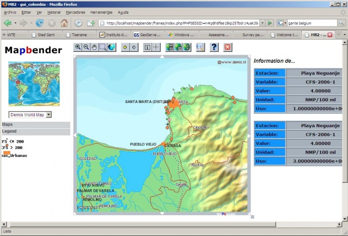

Screenshot of Microbiological quality of the water of Colombia
The data comes as shape files and has been added to a MapServer as WMS and WFS. For usability reasons later WFS was also added using GeoServer.

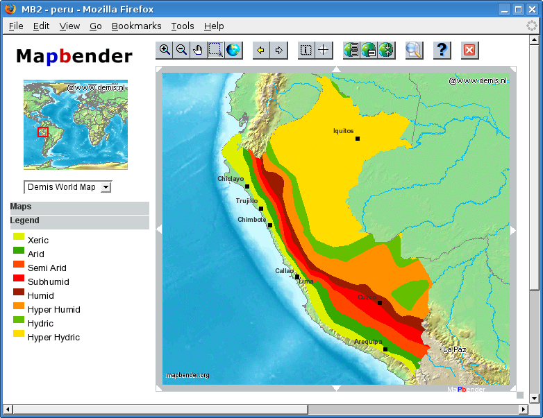

Pantalla de las Zonas Aridas del Peru
Los datos son capturados desde una base de datos en PostgreSQL / PostGIS con la ayuda de MapServer como WMS y WFS.

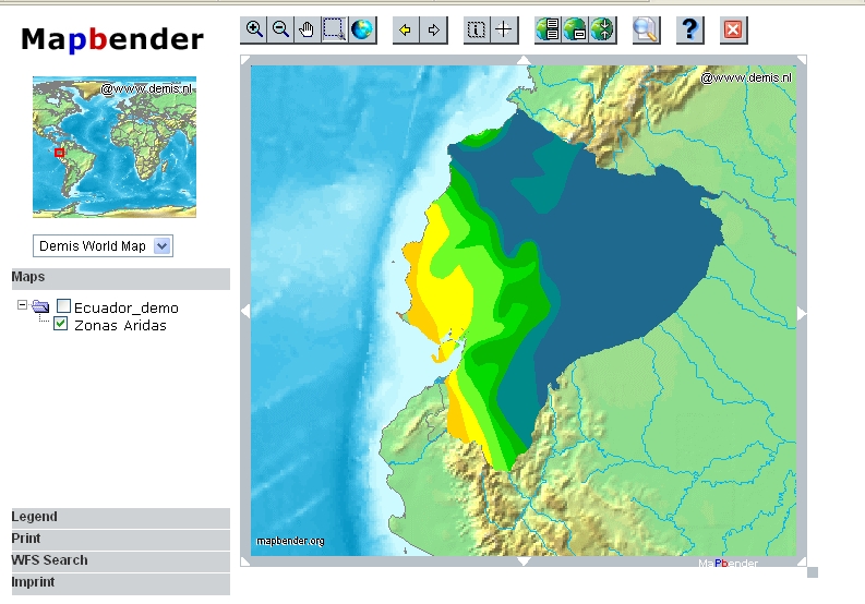

Pantalla de las Zonas Aridas del Ecuador

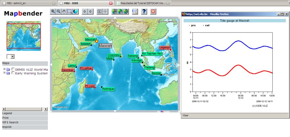

Tsunami Warning System in the Indian Ocean
An overview of the Tsunami Warning System in the Indian Ocean using WMS and WFS. Data is stored in a MSSQL database and rendered by MapServer using an OVF map-file (this simulates a geometry coming from two lat and lon coordinate column). The information window pops up using the usemap module in MapBender.
