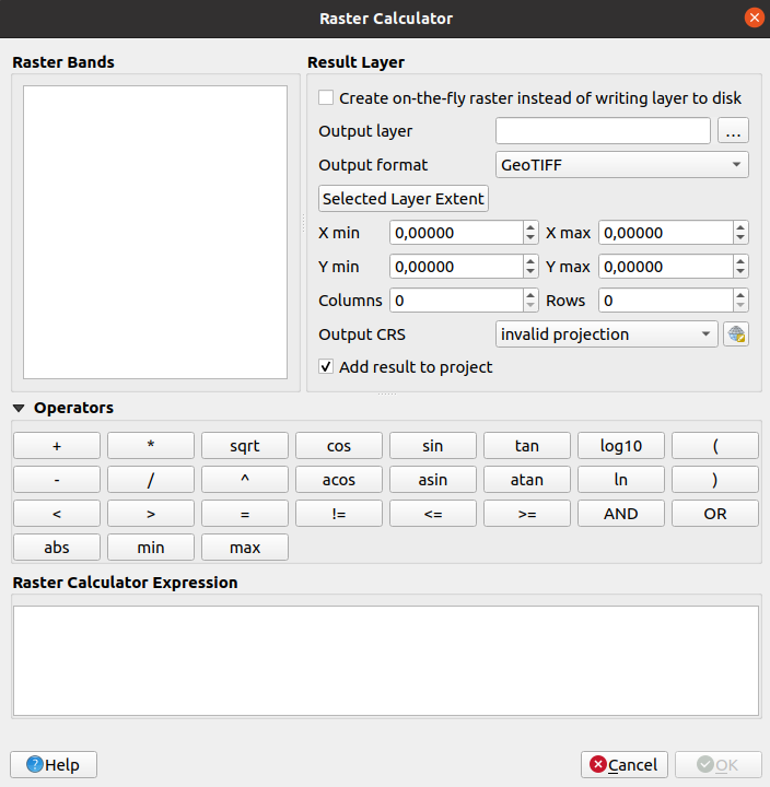

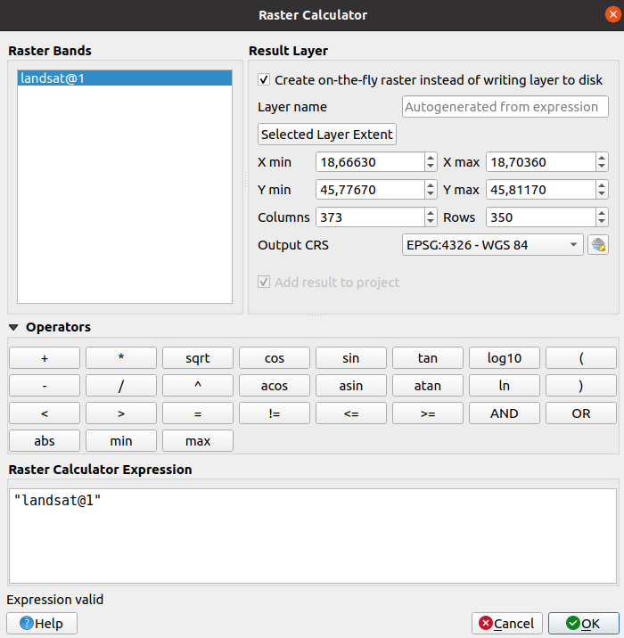

In the next screen is shown a simple example with the raster calculator dialog, where in [10] it is possible to find the animated GIF.
By selecting the checkbox "Create on-the-fly raster instead of writing layer to disk" as it has been described, there will be given the possibility to choose the name, it is also possible to compute a raster that is created by using this feature, so starting from a on-the-fly computed raster it is possible to derive another on-the-fly raster.
