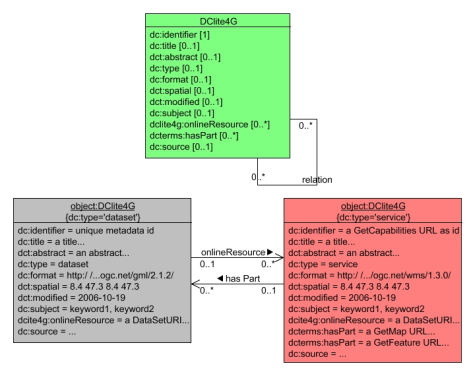

Information model for metadata exchange
This is the 'Dublin Core lite for Geo' (DClite4G) model (http://tinyurl.com/kfkyv).
Some design considerations:
- This is a minimal metadata information model regarding to a metadata exchange protocol for harvesting (e.g. no filter nor GML implementation needed) and according to the ideas about a Simple Catalog Interface/protocol.
- Based on Dublin Core (DC) and Catalogue Services Specification 2.0.1, OGC 04-021r3, p.22.
- Dublin Core need refined semantics of some properties/attributes.
- Have had hard times with the abundance use of namespaces. This is because DC specs and other XML 'practices' specialize properties/attribute types instead of specializing whole classes.
- All properties/attributes have cardinality [0..1] except for identifiers (which are mandatory) and for those attributes which are really needed (as unbounded) for automation!
- Take all information one can in an automated manner, e.g. from data set resource.
Details:
- Services are included in attribute 'format' in the sense that WMS, etc. are just protocol bindings to geodata. Real well known services on it's own like filter or label placement services have a place there too. They could be still detected by challenging them with GetCatabilites (taken from OWS/WxS).
- Indicating of quality of service could be a nice task for search service provider; no need to add it as attribute
- Relationships between features is part of schema metadata: How to handle this...?
Dublin Core lite for Geo (DClite4G)
The following are notes on initial development. DCLite4G contains details of the finalised model which now has an XML namespace at dclite4g.xmlns.com, intended for use in RDF documents though also usable in the context of Atom or KML.
- Aligned and rearranged after some discussions on osgeodata-list and geotools-devel-list. Next steps: first consensus on approach/fields, then consensus about which encoding (DC, RDF or GeoRSS?). - Stefan 08:33, 26 September 2006 (CEST)
- Figure
- Analysis UML class diagram of minimal metadata information model 'Dublin Core lite for Geo' (DClite4G) which consists of a single entity set (green); two entities/instances/records are shown, a 'dataset' (left, grey) and a 'service' (right, red).
