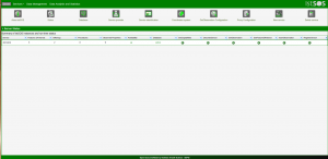

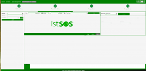

- Designed GUI for all Process time series methods.
- Also Designed GUI for
- Add Time Series
- Process Time Series
- Compare Sensor
- Manage Sensor

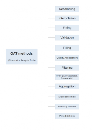

- This week, I’ve been indentifying all the process time series methods in OAT(freewat), I mean:
- digital filter
- exceedance
- hydro events
- hydro indices
- hydro quality
- resample
- data values
- hydro separation
- integrate
- compare
- subtract
- fill
- statistics
- hargreaves

- Adding GUI(OAT extension and its sub-extension) in istSOS.
- Adding functionality of OAT method resampling in istSOS.
