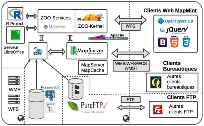

MapMint includes several free software in a complete and coherent web mapping platform, whose operation is based on the use of open standards geomatics and the internet. At the heart of MapMint, we have the ZOO-Project, an application to simply and efficiently deploy WPS(Web Processing Service) data processing. A set of web services is available MapMint, from simple display of a web page in the application to complex geographical treatments. Other types of web services are implemented, including visualization and querying spatial data, WMS(Web Map Service). Access to geographic data in vector format is via the [WFS](https://www.ogc.org/standards/wfs) (Web Feature Service) or access to image data via WCS(Web Coverage Service). All these web services are provided by MapServer. The various files necessary for the functioning of MapServer and dynamic mapping applications are managed by MapMint services which provide a friendly interface for interacting with these web services. ZOO-Project and MapServer applications based on an Apache webserver to access the application via HTTP and HTTPS communication protocols. In the Windows environment, IIS can be used instead of Apache.
Overview of Mapmint Architecture

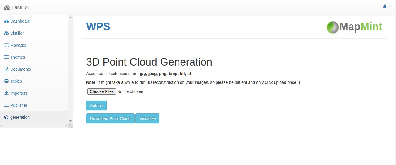

Integrated 3D scene builder as WPS services within MapMint administration User Interface.
- Created a widget on Mapmint administration UI for users to easily access 3D Point Cloud Generation service
- Created WPS services to run 3D Point Generation using zoo-service
- Created some volume to run services and Point Cloud generation smoothly
- Designed the 3D Point Cloud Generation UI from where the user can directly load the images and run the service
- Users can also visualize the generated 3D Point Cloud using the functionality available on UI
- Users can also download the 3D Point Cloud file and can store it locally to visualize using some other software
Now the user can easily create a 3D Point Cloud scene using multiple sets of images from the same scene. 3D Point Cloud generation was done using Structure From Motion algorithm.
Overview of MapMint UI for 3D Point Cloud Generation
