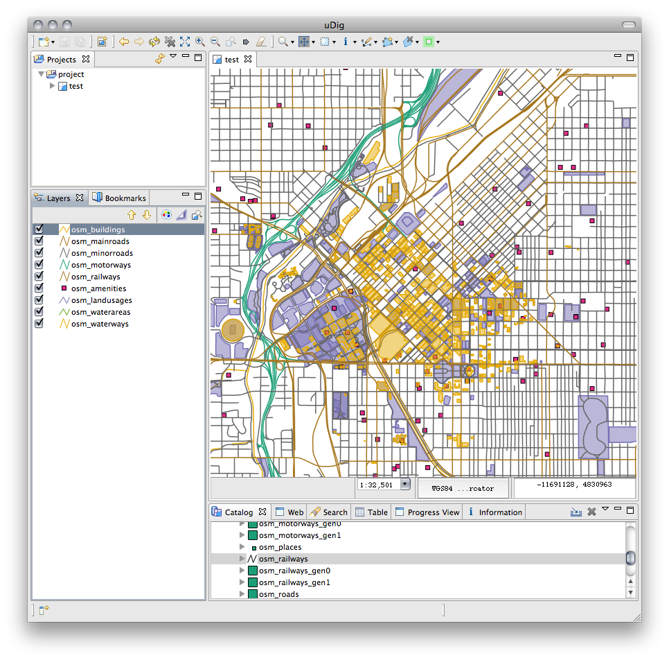

export LD_LIBRARY_PATH=/opt/imposm/lib imposm --read colorado.osm.pbf --write --optimize --deploy-production-tables -d osm --user postgres --overwrite-cache --proj epsg:3857
The --optimize option calls VACUUM ANALYZE on all tables. Autovacuum can be disabled in PostgreSQL (and is).
And that's it:
