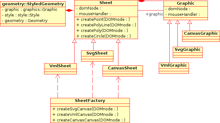

Graphics Class Diagram
Sheet and Graphic represents graphic primitives. They deal directly in pixel coordinates and know nothing about the spatial objects they represent.
Sheet represents a vector rendering engine and is responsible for creating shapes.
Graphic represents a graphic shape (line, polygon, circle, etc). It points to a physical shape in the HTML DOM.
Renderer Characteristics
SVG SVG is inbuilt into Firefox 1.5+, ie doesn't require a pluggin. Not provided in IE 6.0. SVG allows mouseEvents to be attached to shapes. 10,000 features takes ~ 40 secs to render. (MSD3 dataset)
VML VML is similar to SVG, provided with IE 6.0 (& earlier?). VML allows mouseEvents to be attached to shapes. 10,000 features takes ~ 8 mins to render.
Canvas Canvas is provided with Firefox 2.5+. Is reportedly faster than SVG. But you cannot attach mouseEvents to features.
WZ GraphicsA library available for older browsers which draws a line by drawing hundreds of colored DIV tags. This is limited by the size of the data it can render. Suitable for ~ 50 lines, ~ 1000 points.

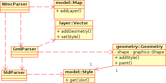

Parsers Class Diagram
The Parser objects will parse source documents (usually in XML format) and build Javascript objects. Documents to be parsed include:
- Geographic Markup Language (GML)
- Styled Layer Descriptors (SLD) Describes style for GML
- Geographic RSS (GeoRSS) RSS with geographic tags
- Context (The Context is an XML description of the layers on a map, the source of the data, and the style to apply to the layers).

Renderer / Graphics / Sheet
Bertil's code:
- Has Renderer.js (which probably should be called RendererFactory.js). It creates Svg.js or Vml.js.
- The Svg/Vml Renderers has a switch statement which calls this.drawPoint() this.drawLine() etc.
Paul's code:
- Used to have a similar Renderer concept - but based upon IeCanvas instead of Svg/Vml. (The code is still there)
- Started working on a Graphics concept with an object for Circle, Line, etc.
Cameron's design: http://wiki.osgeo.org/index.php/AJAX_WebMapping_Vector_Rendering_Design#Code_Review
- I propose that we split the Renderer into two classes.
- Renderer.js should loop through all features, call the appropriate drawFeature function, with the correct style information.
- Sheet.js (should be called Canvas, except Mozilla already use the word). Sheet.js contains all the drawLine, drawPoint, drawPolyline etc functions.
- Sheet.js has children Sheet/Svg.js Sheet/Vml.js etc.
- SheetFactory is a simple class which returns the correct instaniation of Sheet.
My aim here is to seperate the Cross-browser Graphics from the GIS code. Seperating the Graphics out will make it easier for us to build upon Graphics libraries that will be developed and optimized by other projects.
