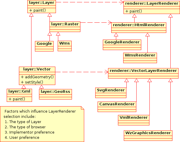

Layer/Renderer Class Diagram
The key here is that the DataSource (or Layer) is being kept seperate to the Rendering mechanism. This is a graduation away from existing OpenLayers code which previously merged the DataSource and Rendering in the same Object.

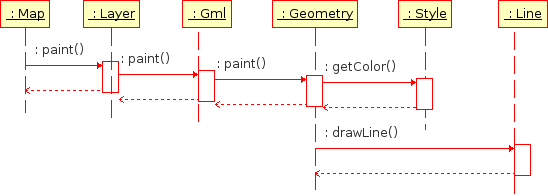

Paint Sequence Diagram
